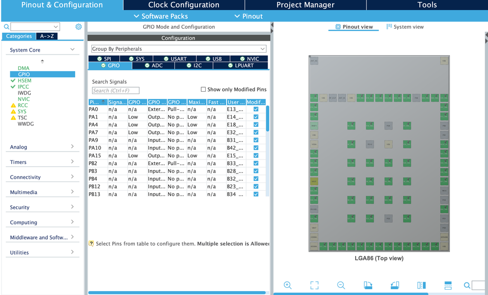

I have purchased a steval astra 1b and tried to use it with cubeide; but the problem is that many pins are selected by default on gpio, this thing last time I opened the project was not happening.
I tried with bard or chatgpt but with poor results.
I hope someone can help me.
P.S: I wrote this text in English because it is the international language, but I am Italian and I am not very good with English (so I would like to know if there is also a section in Italian)Screenshot 2023-10-30 alle 19.16.56.png
this is a project i just created with the steval astra 1 b board (i didn't change any parameters)

I assume you answered No to the question "Initialize all peripherals with their default Mode" the last time you created a project. If you answer the question with Yes, the image essentially looks like in your screenshot.
Please note that the STEVAL-ASTRA1B is an evaluation board where STM32WB5MMG already has external connections (to sensors etc) that need to be taken into account. Only if you create your own board with STM32WB5MMG, you have complete freedom (within the necessary connections).

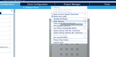

I was finally able to fix it; it was necessary to go on pinout ad click the voice "Clear pinout" (Like this).

On the first point: Clear Pinout does indeed remove all pin assignments, but its purpose is questionable in a finished STEVAL-ASTRA1B - the connections are still there, after all.

As for the Clear Pinout function, it has visibly resolved my problem (hopefully it has really resolved it).
