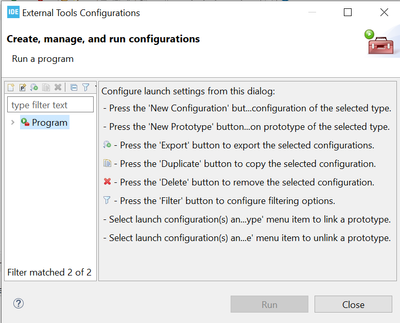

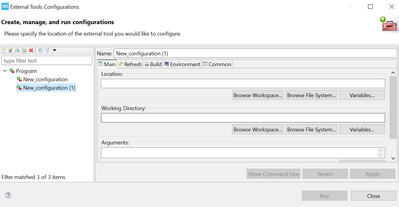

2- Configure External Tools in STM32CubeIDE:
Go to Run > External Tools > External Tools Configurations....
Create a new configuration for your script.
Set the location of your script and any necessary arguments.
