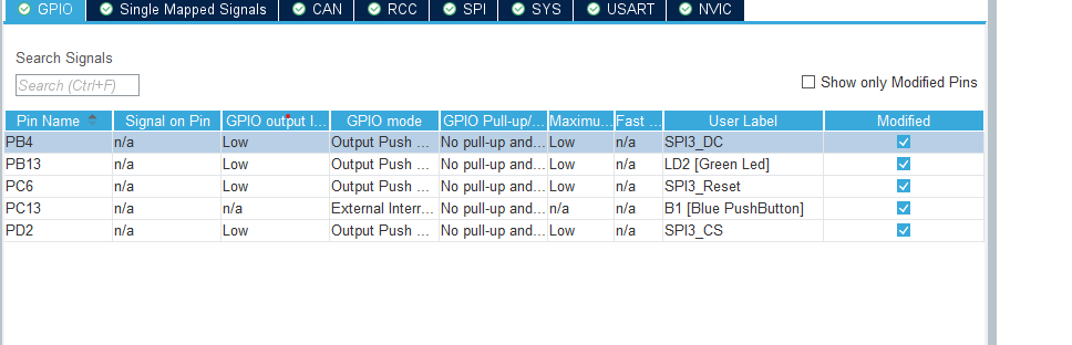

Trying to setup SPI for ssd1306 in STM32CubeIDE based on the code from "afiskon" in Github.
Problem is that I'm new to this processor and the IDE.
Could someone please help me?
I'm using the NUCLEO-F302R8 board and I have set up the following GPIO ports additional to the SPI3 bus.
Does anyone have a good example, because I can't find an howto on Youtube or somewhere else.
BR
Johan

I’ve now been trying to get the SPI communication to the OLED to work for three days without any luck.
There is no good examples on youtube, what I found so far.
I haven’t got the faintest idea what the problem could be and I would really apricate your help.
I’ve connected it directly to my Nucleo-F302R8 board.
I also changed the code in afiskon's example code to get led and pushbutton working so I know that it enters the OLED test mode.
I’ve checked all connections, configured the conf file, but still no action on the display.
For you this might be an obvious fault, but I’m stuck.
