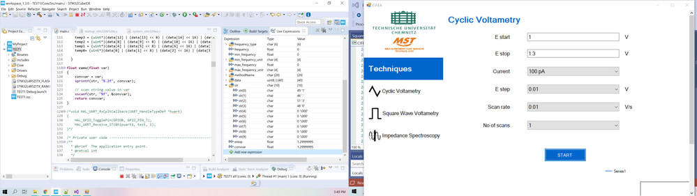

I have win forms GUI and sending data from this GUI to STM32 Nucleo L4R5ZI µC over UART in byte array format. After receiving data over UART in µC, I am converting the data to their native formats such as Int ad Float. I don't have issue converting int, but float data is converted with too much precision i.e) 1.3 from GUI is converted as 1.29999995 in cubeIDE. That'y I implemented a function with sprintf and sscanf to convert 1.29999995 to 1.3. Sprintf copied the value to str (str is char array) 1.30, but sscanf is unable to copy the value back to float variable. Please have a look at the image for more info and also have a look at the code snippet. Please help me in this regard.

Hi TDK. Thanks for the reply. I understand your answer. But, my problem is why sscanf is unable to copy the value in str to convvar ? If that is possible then I can retrieve the original value i.e) 1.3.
2020-06-07 7:32 AM
Your screenshot shows a value of 1.29999995 in convvar. Why do you think it's not there?
2020-06-07 7:39 AM
Please look at the live expression window. I am passing 1.29999995 in convvar. After sprintf statement, the value in convvar which is 1.29999995 is limited to 2 deciaml places and copies 1.30 to str (you can check from live expression window in the screenshot). My question is why sscanf is unable to copy the value 1.30 from str to convvar ?
2020-06-07 7:52 AM
Because the exact value of 1.3 is not representable as a variable of type float, as I wrote in the first response.

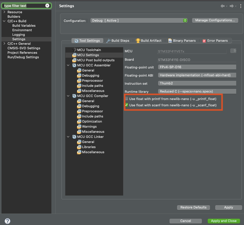

May be I am very late to answer this. :;
In order to use 'float' type with 'scanf' and 'printf' functions in CubeIde, you need to enable it in project settings.
Hopefully this solves your issue. And this will parse float 'string' to a float variable.
