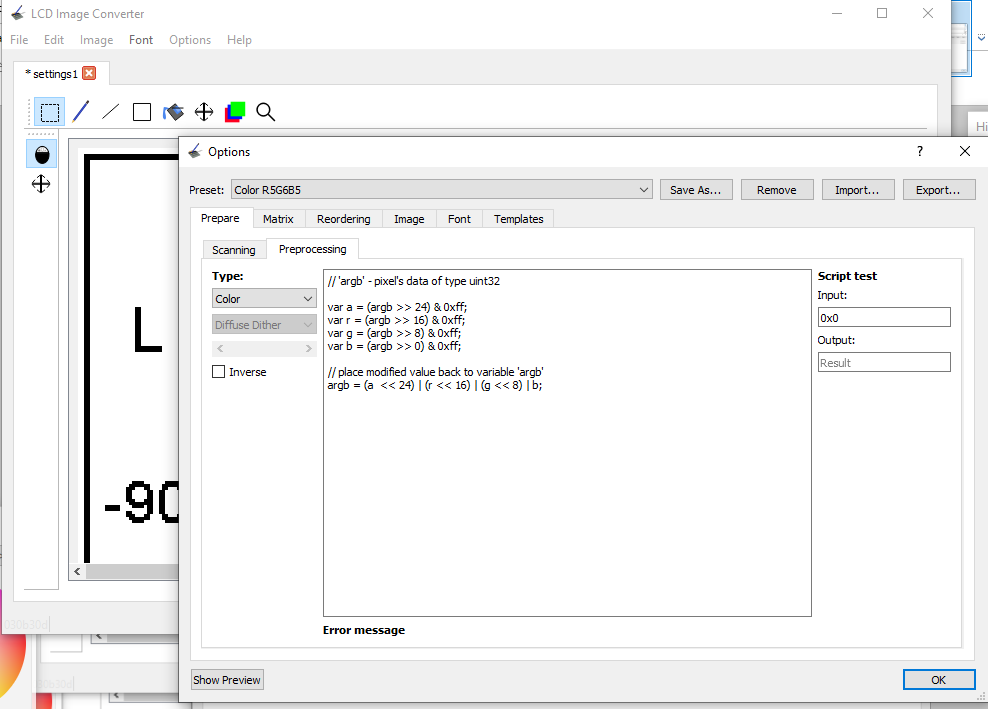

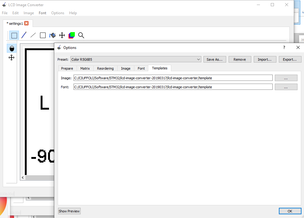

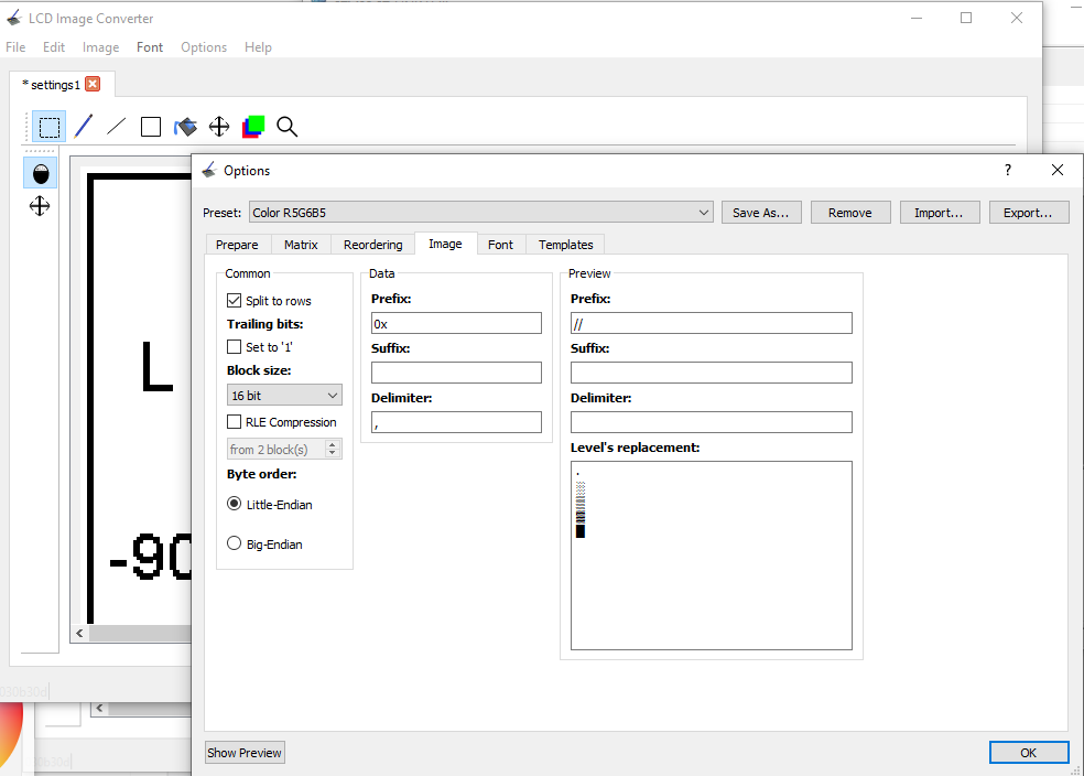

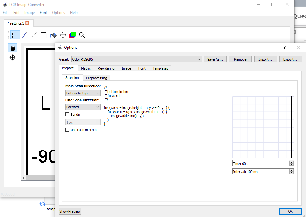

I have used the lcd-image-converter.exe to convert the bitmap files to a bitmap structure to pass to BSP_LCD_DrawBitmap().
Here the settings used for cd-image-converter.exe.
0693W000006FZaIQAW.png0693W000006FZaNQAW.png0693W000006FZaSQAW.png0693W000006FZaXQAW.png

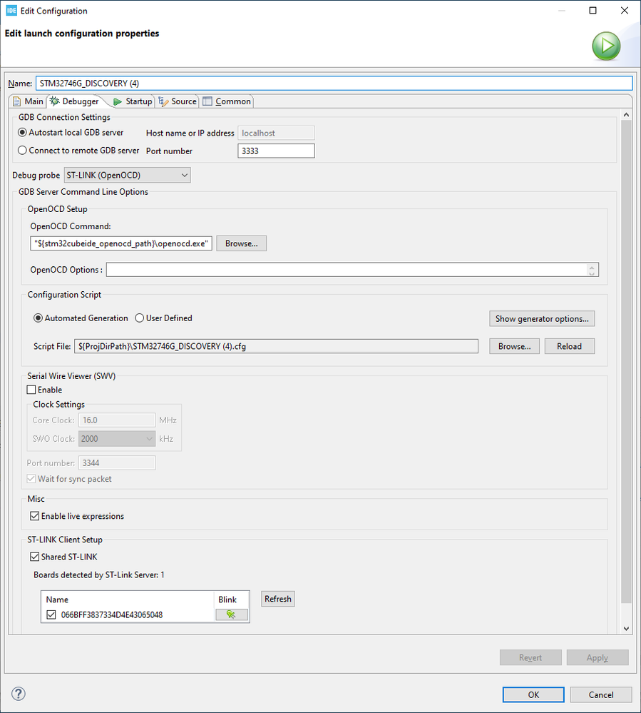

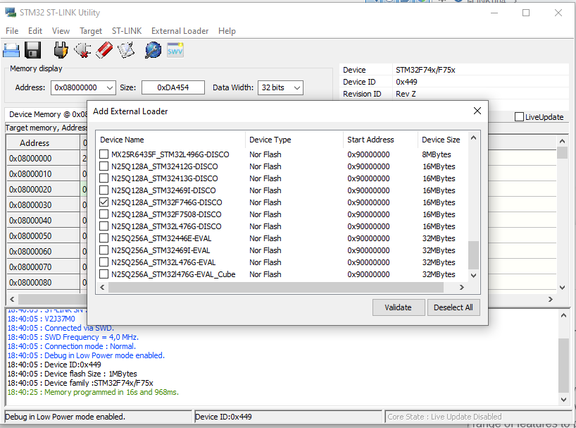

Install ST-Link Server and set these options in Project/Properties/Run-Debug section
0693W000006FZbLQAW.pngor use the external ST-LINK app with this set
