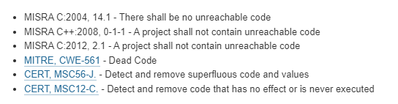

For more information, here is the SonarQube rules :

2024-02-26 8:28 AM
I'm talking about quality. Not about compilation error.
The program compiles well and runs. But SonarQube (quality tool) return that the first code is not well written.

2024-02-26 9:39 AM
Here, its not about code quality, but about follow the norms of your compiler.
