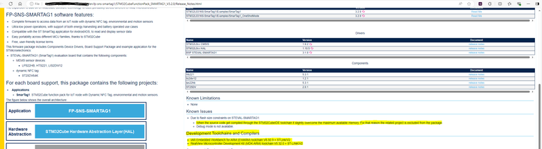

Hello @isaacseeto ,
I apologize for my late reply. The STM32CubeFunctionPack_SMARTAG1_V3.2.0 package is developed with IAR Embedded Workbench for ARM (EWARM) toolchain V8.50.9 + STLink/V2 and RealView Microcontroller Development Kit (MDK-ARM) toolchain V5.32.0 + ST-LINK/V2 Toolchains as mentioned in the release note. The STM32CubeIDE project is not available in this package.
The STM32CubeIDE project is excluded from the package due to flash size constraints on STEVAL-SMARTAG1.
Please take a look at Known Issues in the below figure.
For that I recommend you to use IAR or MDK-ARM toolchains.
Thank you.
Kaouthar
