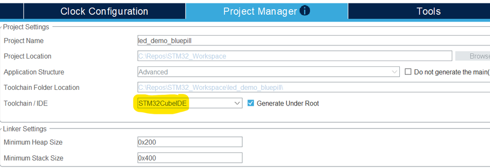

2025-12-17 5:19 PM
Hi
As they mentioned, in the latest release , STM32CubeMX is no longer integrated in STM32CubeIDE 2.0.0
So now what I do, is first I launch STM32CubeMX and create my project folder
Note: make sure to select STM32CubeIDE, otherwise it won't work (imo it should be selected by default)
then I open STM32CubeIDE 2.0.0 and import my project folder to start coding.
