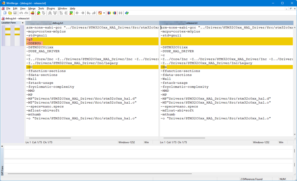

2024-04-11 4:08 AM
2024-04-11 4:24 AM

2024-04-11 7:26 AM
So here's the differences:
-g3 enables debug info in the ELF file:
You could start by enabling that in the Release config, and then use the debugger to investigate what's going on.
-Os enables optimisation for size:
When changing (especially increasing) the optimisation level breaks your code, it usually indicates that there are latent bugs; eg, volatile missing where it should have been used.

2024-04-11 8:03 AM
Thank you for that informative reply.
This is stock solution using STM32CubeMX. I haven't made any changes to the compile options.
