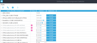

>how I would "download from within STM32CubeIDE"
the ide doing this auto.
just in (.ioc) Cube-window you can select, what you need (and what is possible) and then ide downloads, what is needed
here: software packs
then you see:
