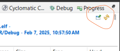

2025-02-07 1:07 AM
Have you refreshed the build analyzer? Sometimes it doesn't refresh on its own. Rebuild and click the refresh icon:
Also, why did you remove const? You cannot put a variable in ROM, only constants. The linker won't like it. And if it somehow builds you will get a hardfault error if the MCU tries to modify the object.
