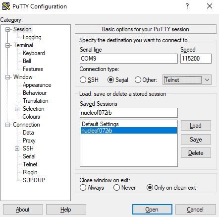

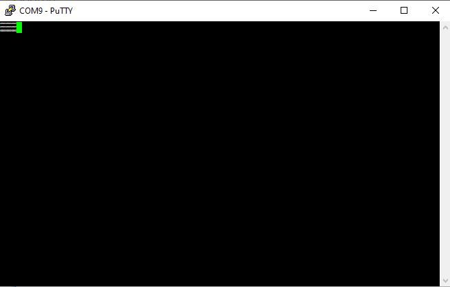

2. When I try to access the Port status with the CLI (PuTTY) it shows me the following output everytime I Press the B2 Button:
I use the following Settings:
Baudrate: 115200
Data bit: 8
Parity: none
Stop bit: 1
Hardware Flow Control: None
I got the library and code from the official Website
As stated in the Readme I importet the Project "STM32F072_MB1303_DRP_2PORTS" into the STM32CubeIDE.
I am using the Version 1.10.1 of the STM32CubeIDE.
Best Regards and Thank you in advance.

About CLI, there no 'CLI out' like demo code embedded into fresh board, that's why you cannot get trace.
You can use https://www.st.com/en/development-tools/stm32cubemonucpd.html#get-software to get message traces.
