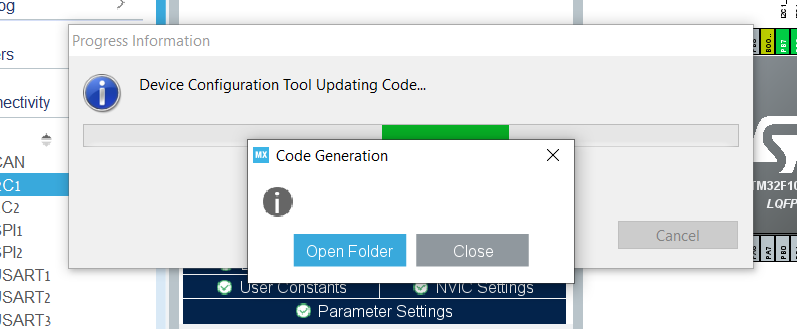

I bought Blue pill (stm32103c8) and downloaded the stm32IDE.

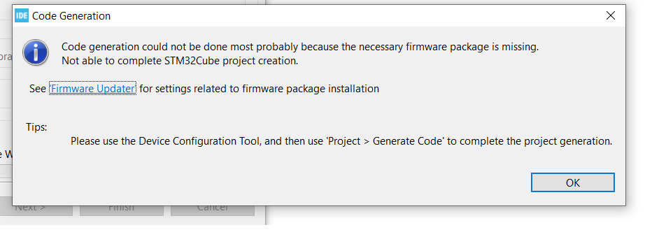

Once I try to open project, after I choose the board I get a message that there is a problem
and the reason is probably I don't have the necessary firmware.
After I try to generate code I see this.
I can't complete my project opening.
What can I do?
2021-05-23 7:29 AM
Go to Help -> Manage Embedded Software Packages and download the missing software package.
2021-05-23 7:29 AM
