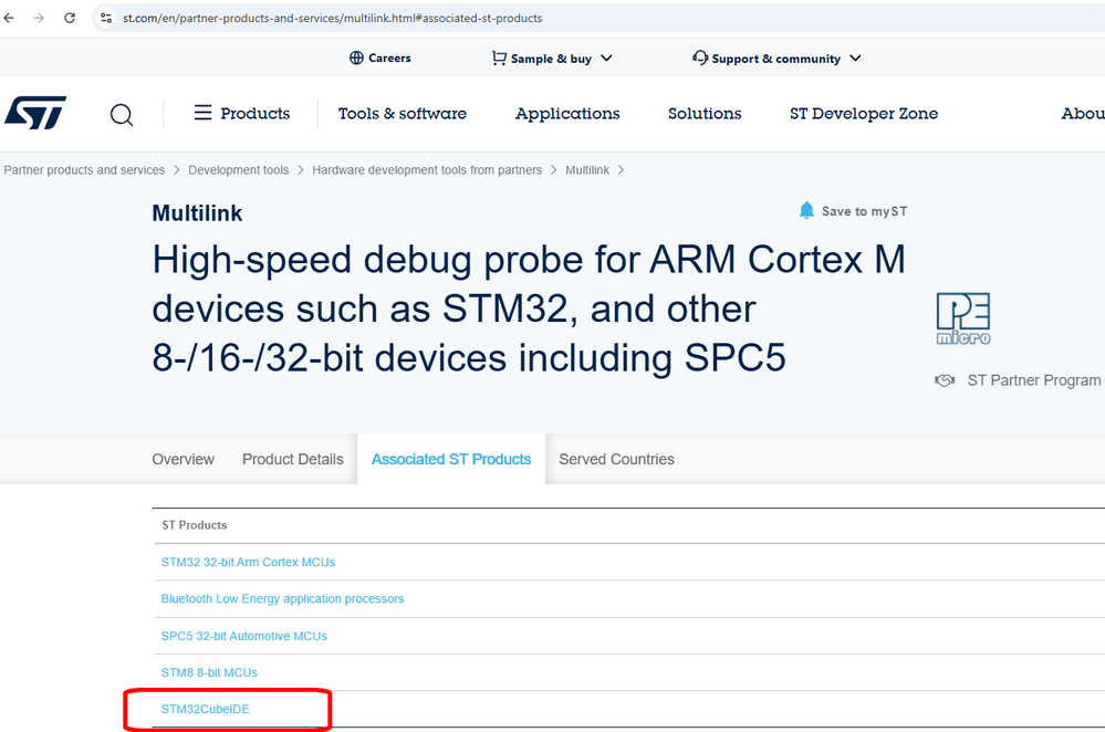

STMicroelectronics officially supports PEmicro debugger.
https://www.st.com/en/partner-products-and-services/multilink.html
https://www.pemicro.com/products/product_viewDetails.cfm?product_id=15320180&productTab=5051
I think that mischaracterizes the relationship. PEmicro has tools that support STMicro parts, you should use PEmicro software with PEmicro tools.
2024-11-18 4:53 AM - edited 2024-11-18 4:58 AM
@Tesla DeLorean wrote:>>STMicroelectronics officially supports PEmicro debugger.
Indeed.
However, to be fair:
I do think that ST needs to clearer about what, exactly, the "Partner" relationship entails.
@STTwo-32
@mahendrakumar it generally does not mean that ST provides support for the Partner's product(s).
