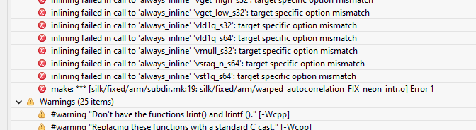

I started by using CubeIDE to generate an empty library project with the STM32H723 as the target. I then imported all of the relevant source code from the Opus Profiling Tool application (which is excellent by the way!). But getting my new project to build has been a struggle. I have manually linked all of the (apparently) necessary folders, but continue to struggle with build errors.
The latest hurdle is with an error dealing with inline code that is not "inlining" properly. It seems to imply that there is a "target specific option mismatch" but doesn't elaborate. This all seems to revolve around the "neon" version of the intrinsic fft code.

2024-12-07 5:58 AM - edited 2024-12-07 5:59 AM
Try enabling compiler flag OPUS_DISABLE_INTRINSICS
