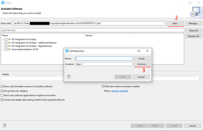

Do anyone know how to install the Egit plugin in an offline machine(Windows)?
2023-06-20 1:43 AM
you can download the latest build of EGit from this web page (or this is the direct link). That is a copy of the update site packaged into a .zip file. You can use that zip file following these steps:
2023-06-20 1:43 AM
2023-06-21 3:54 AM
Dear Stefano,
It's good to see you here (again). I hope you're doing fine, and I thank you for providing me the detail solution.
