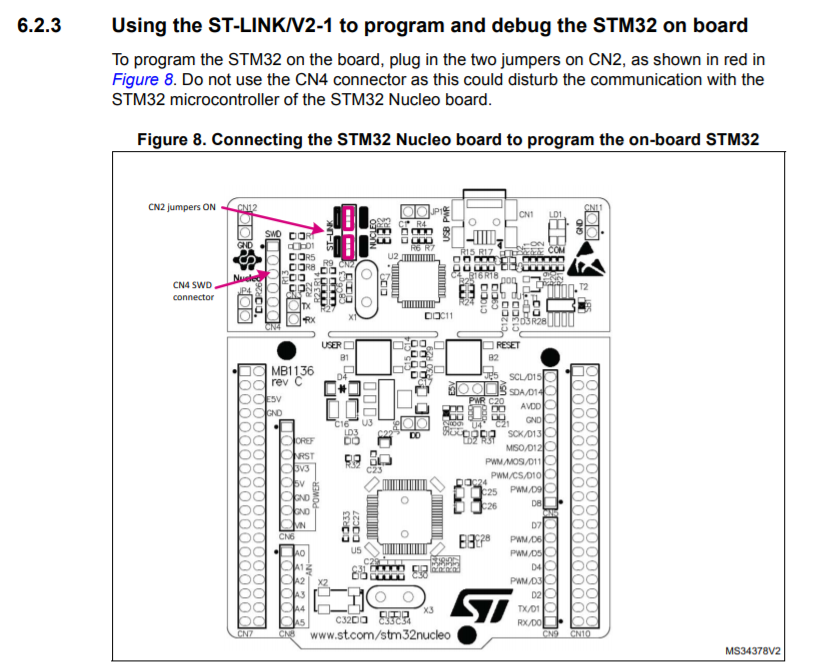

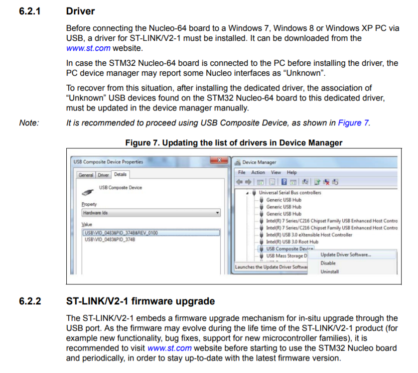

Having trouble connecting with this Nucleo on my Windows 10. Using UM1724 User manual document I have looked at jumper connections and driver updates. I've tried using STCubeIDE and the ST-Link Utility SW to upgrade the FW, I also tried ST-link007 and ST-link009 USB Drivers.
I also found a section talking about if the Nucleo was plugged in to the computer before the driver was installed, it could lead to the device being "unknown". I'm not sure if I am guilty of this, but I followed their process for recovering if this was the case. It also told me that my "USB Composite Device" is up to date and wouldn't update the driver.
Jumpers set to CN2 ON, JP5 power to U5V and IDD ON.

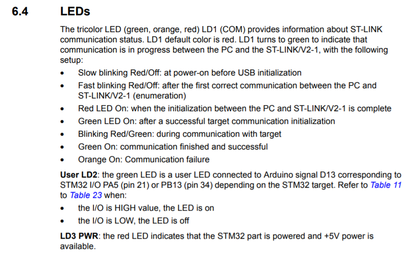

Whenever it's plugged in I typically get the slow flashing red LED1 with a solid LED3 (indicating "power-on before USB initialization"). At some point I did get a fast flashing LED1 (indicating  "after the first correct communication between the PC and ST-LINK/V2-1"). Haven't gotten it to repeat that one though.
