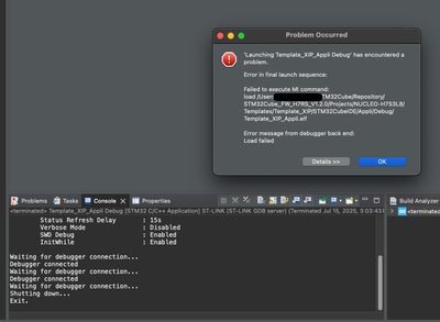

I bought a Nucleo-H7S3L8 and I'm trying to build and execute the XIP_Template and I'm following the official guide.
at first I built the Appli project and I choosed the first debug option and got the following error.

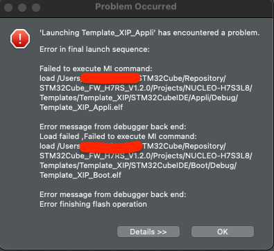

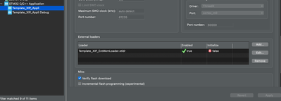

to solve it I found a post in the community and followed the guide there and changed the config of the "Template_XIP_Appli Debug" and added an External Loader "MX25UW25645G_NUCLEO-H7S3L8-XSPIM1.stldr"

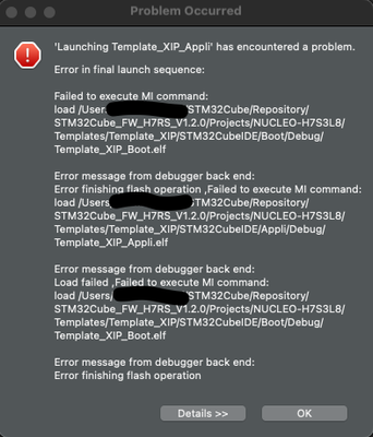

and also "MX25UW25645G_NUCLEO-H7S3L8-XSPIM1.stldr" but got this error instead
what is confusing to me is that there is now to debugging options and the first one have this External Loader
"Template_XIP_ExtMemLoader.stldr" but the second was
I didn't found any other solutions and the project could not be debugged or uploaded to the Nucleo Board , can anybody help or give me some tips?

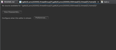

Now the script runs fine, and the project uploads to the NUCLEO board. However, after upload, I see this warning:
No source available for "(gdb[4].proc[42000].threadGroup[i1],gdb[4].proc[42000].OSthread[1]).thread[1].frame[0]"
The project seems to run and debug just fine, but I'm curious what that message actually means. Is it something I should be worried about, or can it be safely ignored?
