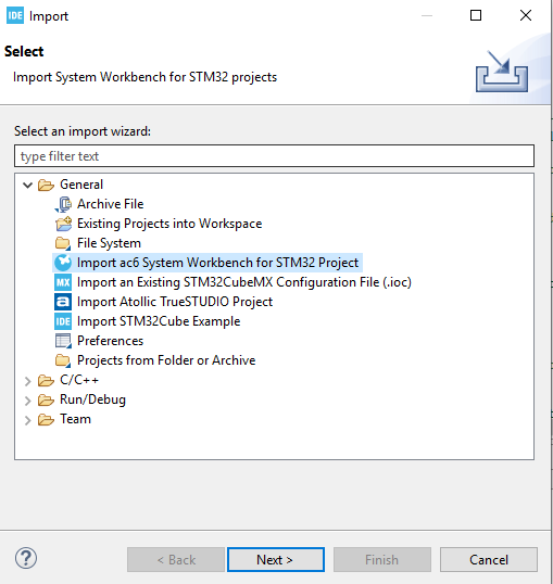

Have you got a try to STM32Cube_FW_F4_V1.25.1\Projects\STM32F429ZI-Nucleo\Applications\LwIP\LwIP_HTTP_Server_Netconn_RTOS ?
Ok SW4STM32 based example but such is fully STM32CubeIDE supported. Just rely on proper import feature and you're done:
