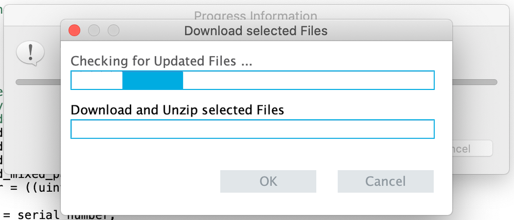

got another problem. I am unable to create new project. It keeps "checking for updated files" but never finishes.
Just FYI: I updated MacOS Catalina 10.15 (19A602).0690X00000AqZfmQAF.png

Never mind. There is already a solution for this problem on the forum.
stm32cubeide-for-mac-is-stuck-on-checking-for-updated-files
Since I am very new to the software it took me 10min to find the setting they were talking about to change.
Here it is, step by step.
Preferences (of STM32CubeIDE)> Instal/Update > Available Software Sites. Uncheck Both "STM32CubeIDE Repository" and "Eclipse Repository".
