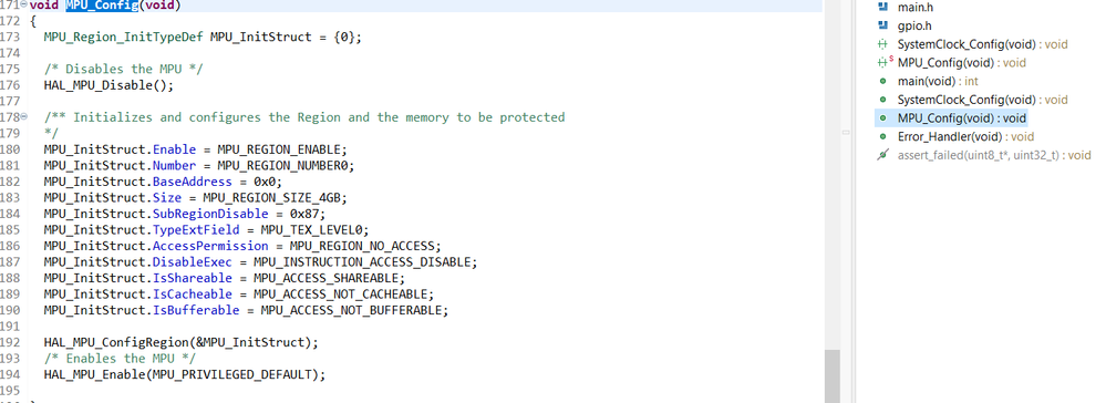

I am working on STM32H743VIT6 MCU. when I generate the code, I get MPU_Config(void) function instead of MX_GPIO_init(void) with no GPIO configuration. How can I fix this?

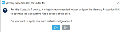

Salam @Afsd24
For this cortex-M7 device, it is recommended to preconfigure the MPU. So, on the last versions of CubeMX when you select this MCU and a few other cortex-M7 MCUs and Click on start project you will receive this message:
Clicking Yes will generate a configuration of the MPU on the function MPU_Config(void). If you don't want, you just have to answer No to this message.

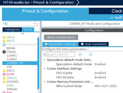

Could you please provide which CubeMx version you are using?
Could you please attach your .ioc file?
Afsd24
Associate II
Here is the .ioc file. now I get the MX_GPIO_init(void) function but i still have MPU_Config(void)
(i also use the devEbox H743 board)
so just dont use the MPU , if you dont know how to use :
