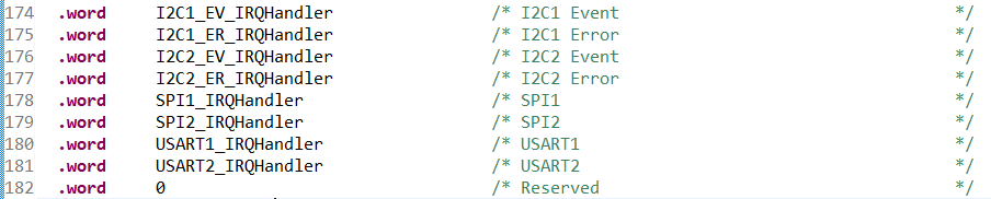

Hi @Drexter ,
Trying to do the same on my side:
==> USART1 & USART2 IRQ Handlers are there:
Could you please check on your side using attached .ioc file or share with me the ioc file that can help to reproduce the problem?

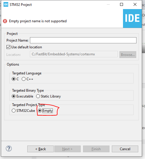

So one thing I forgot to mention is that I start the project with "Targeted project type - Empty" (see attachment).
But as far as I understand, that should not be the reason why some Handlers do not show up in the .s file.
When I tried to create a project with target STM32Cube (and also checking your .ioc file), the handlers were there.
What other reason could there be that the Handlers don't show with Empty project specifically when used on the 410RB Nucleo board?
