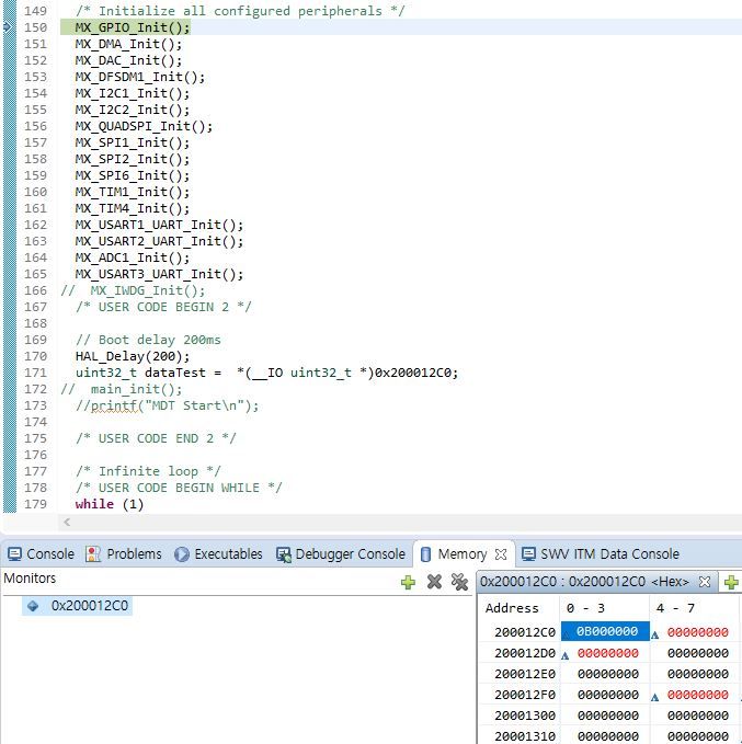

2020-06-21 10:16 PM
I use CubeIDE 1.3.0, STM32F769II.
When i debug variable value.
I found value having strange value.
It always happen when i click "reset chip".
Memory address is 0x20012C0.

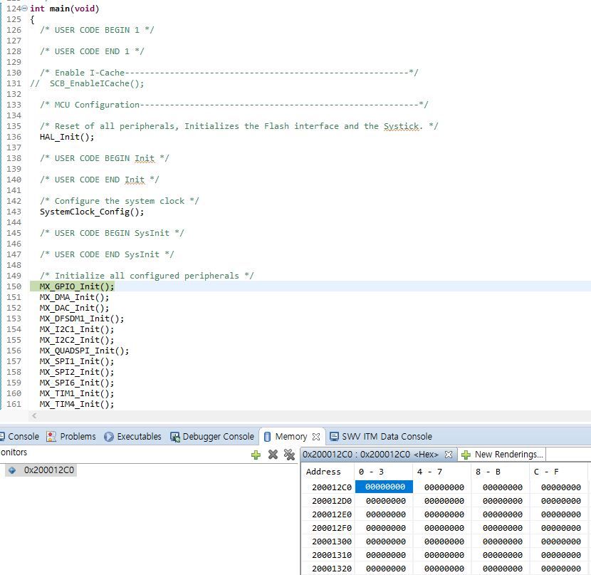

when i start debug. It have 0 value.
But when i click "reset chip". 0x20012C0 memory value is changed.
How can i fix it.
Please help me.
Thanks.

2020-06-22 2:34 PM
Place a data breakpoint on that address, or single-step from the reset vector.
2020-06-22 2:41 PM

2020-06-22 5:10 PM
You are right.
I set break point this address.
Reset_Handler change value sometimes.
But i allocate 0x20012C0 address into .data sector (Initialized global variable) not .bss .
finally 0x20012C0 address value should be set to 0.
Because it initialized global variable.

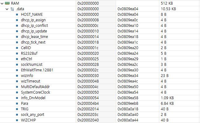

2020-06-22 5:31 PM
Usually you just define variables and let the linker sort out where to put them. That way there is a clear separation between .data and .bss. The default startup script relies on this to be the case.
How did you do this? What does your linker file look like?
2020-06-22 5:40 PM
Thank you for your answer.
I define large size variable.
"Para" variable allocated 0x200004b4 ~ 0x20002014.
