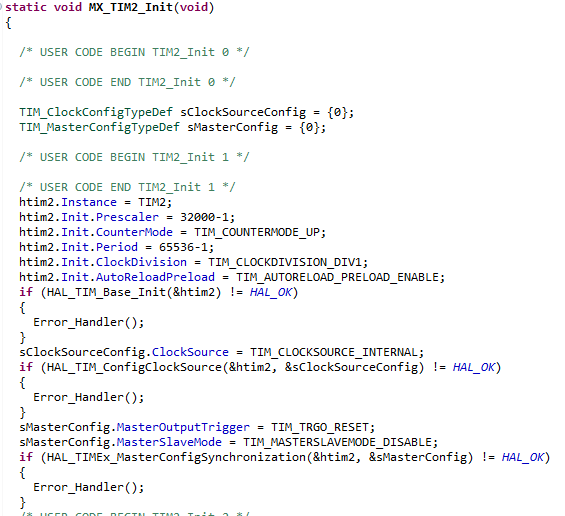

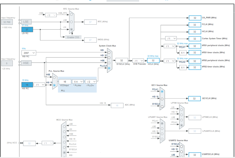

2021-05-25 3:36 AM
STM32CubeMX clock configuration settings (MCU works at maximum 32 MHz):
Generated Timer init function:
The maximum period I can enter is 65 536 ms (2^16) which is 65.536 seconds. If I enter for example 70 000 then timer interrupts every 5 seconds.
How could I set period to 10 minutes (600 000 ms)?

2021-05-25 3:49 AM
Set it to 1 minute (60 seconds), and in the interrupt service routine (ISR) count to 10.

2021-05-25 3:24 PM
No. Other STM32 do have 32-bit timers, but not the 'L0 family. Cosider the other options I've mentioned.
