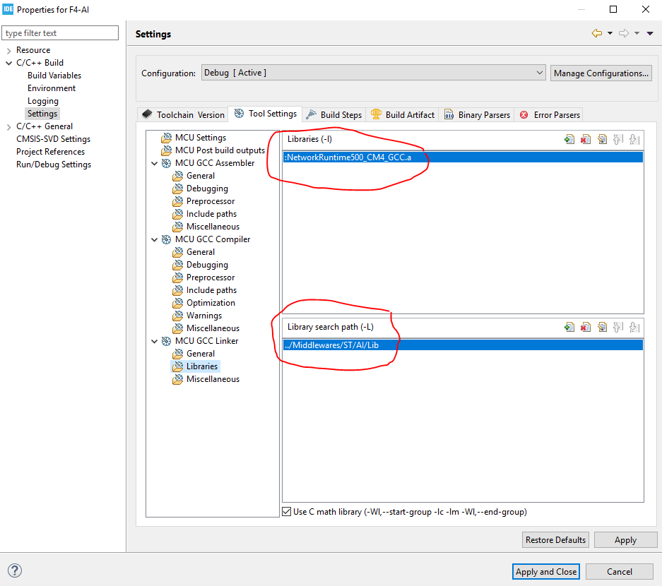

2020-02-10 10:21 AM
May help maybe ... some binary inclusion setup example from AI pack usage. Let's promote your own material this way...
