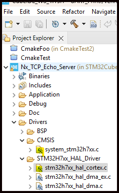

> I would like for the IDE to somehow make easy for me to know that the file I am currently viewing is a linked file.
The IDE indicates linked files by small arrow overlays on the icons:
The resolved location of linked file can be seen in Properties-> resource.

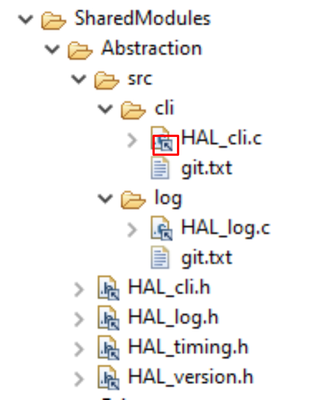

Thanks for replying Pavel. Unfortunately, my IDE is not showing the yellow:
I'm using revision 1.18.0 of the IDE.

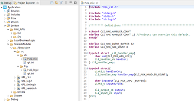

That helps. Is there anyway to flag the editing window? The tree structure doesn't track the currently open file in the editing window.

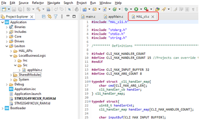

2025-04-01 1:33 PM
Look again at the screenshot in my last post. While the instance of HAL_cli.c has a small arrow overlay. The icon in the tab of the editing window does not.
Here is another example screenshot:
I placed a red box around the tab in question. If the icon there also had this small arrow overlay I think that would be adequate for helping a developer realize the file they are editing is a linked file.
I added Kudos to your's and Pavel's comments. I did not click on "Accept as Solution" for Pavel since I see it as only a partial solution. Is that acceptable etiquette?
