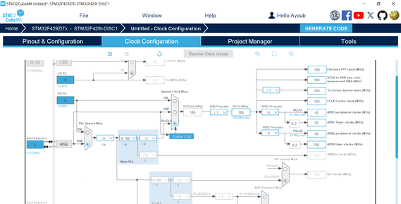

TIM1 / APB2 is likely not clocking at 180 MHz, but a fraction of that. So perhaps 90 or 45 MHz ? Check the divider settings and Clock Tree, in this context.
Also Toggling will further half the frequency (double the period) of a blinking LED
APB1 DIV4 is 45 MHz, TIMCLK= APB1*2, so 90 MHz
So 1000 delay is 2 seconds, LED ON at 4 second interval ?
i checked the Clock tree, the APB2 bus is working on 180 Mhz , and in the Timer configuration in PSC register i wrote 180-1, that means 180Mhz divided by 180 is 1Mhz which is 1 tick in on microsecond STM32CubeMX Untitled__ STM32F429ZITx STM32F429I-DISC1 07.06.2024 15_42_38.png
