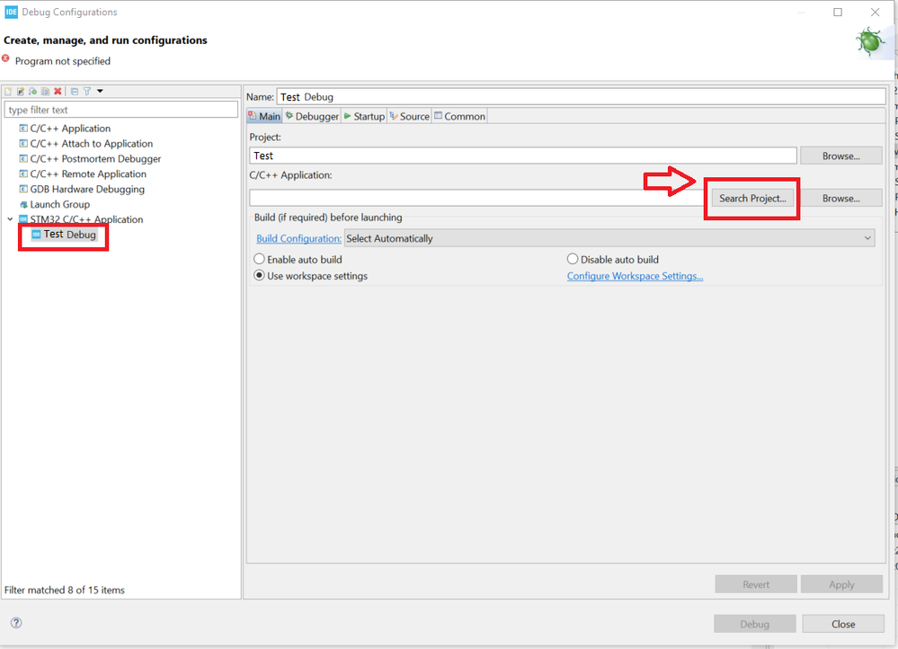

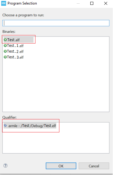

As a workaround I suggest to delete all binary files and rebuild the project or choose the right .elf file under Debug Configurations as the screenshots show.
