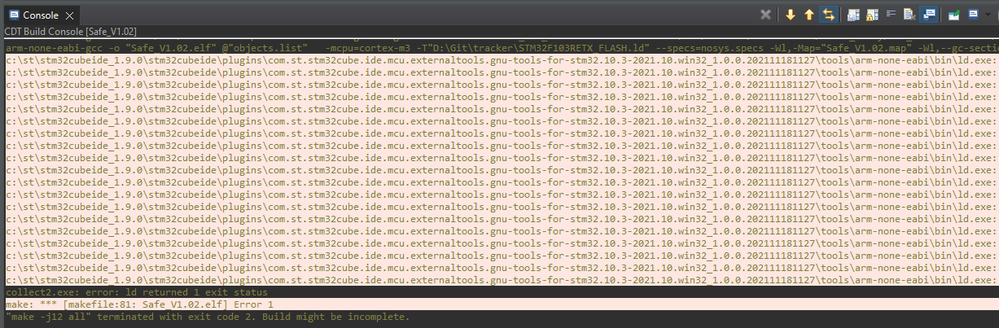

2022-03-08 5:37 AM
2022-03-09 2:19 AM

2022-03-09 4:06 AM
i can confirm. I had the same issue!
I am working on STM32F1/F4/G0 projects with C and CubeIDE.
All projects, that worked fine yesterday with CubeID 1.8.0 now throw lots of linker errors "first defined here" and "multiple definition".
For me it looks like a bit the
#ifndef HEADERFILENAME_H__
#define HEADERFILENAME_H__
{code in header file ...}
#endif // HEADERFILENAME_H__
is no longer interpreted correctly.
The list of "multiple definition" & "first defined here" is huge, it seems like allmost every exported variable of the project is affected
My workaround is: uninstall CubeID 1.9, reinstall Version 1.8.0 and pull the Projects out of the backup - i LUCKILY made before upgrading to 1.9
