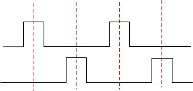

Is there anyway I can configure the STM32L476 to get a PWM waveform such as is shown in the jpg file attached? I have tried complimentary and TIMx-CH1N is exactly the opposite of TIMx-CH1. Adjustable DutyCycle with DeadTime.

You should be able to do this with a single timer on CH1 and CH1N channels. Set it for 50% duty cycle and adjust the dead-time to give you different duty cycles. With zero dead time, the channels are opposite, but with nonzero dead time they will be different.

Thank you for your answer but if setup the PWM as you suggest I still get the complementary and not the push-pull output that I require:

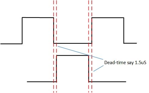

D/C is Duty Cycle. It is expressed in percent.
I want to change the D/C depending on the MPPT point of a 375watt 90Vdc solar panel array feeding a load via a PCB with a full H-Bridge at a frequency of 25KHz.
My system will start off with a low value of D/C, say 5%, and increase the D/C until the MPPT point of the incoming solar array is reached.
I realise that there will be no D/T viewed if the D/C is low as electrically they is no need for it. Approaching the 50% mark the D/T should become visible as per image0693W000005AtE8QAK.jpg.

This exactly is the purpose of deadtime insertion in the Advanced Timers (TIM1, TIM8).
If you don't see this, there's something wrong in the setup.
Read out and post the content of TIM1 registers.

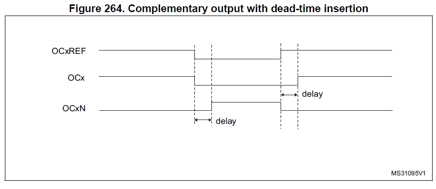

TDK
Super User
I'm as sure as I can be that this is possible with dead-time generation.
