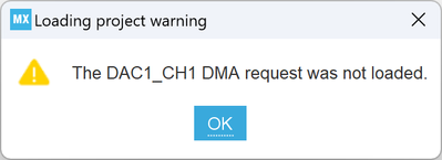

Hello @hannah
When I open this .ioc file I have this problem and the .ioc file is empty:

2024-09-03 6:08 AM - edited 2024-09-03 6:14 AM
>What this means "I am a STM32F72IEK6 µC at NUCLEO-G474RE board."
it should be ''i am using a STM32F72IEK6 µC at NUCLEO-G474RE board."
Do you have any idea, why comes this warning, or what should i change maybe in text file, so i can open it normally?

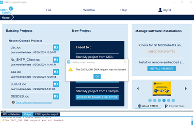

2024-09-03 6:36 AM
i leave a pic of my screen, when i try to open the file.
2024-09-03 6:43 AM - edited 2024-09-03 6:43 AM
I said : use the independent CubeMx instead of CubeIDE to open your ioc file.
Please download it from here: https://www.st.com/en/development-tools/stm32cubemx.html
