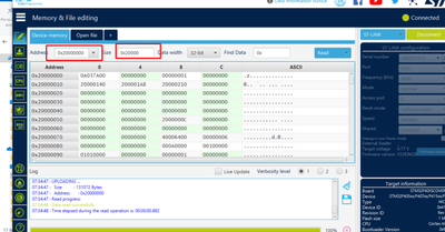

In order to see the content of the RAM, I started CubeProgrammer and entered the address as 0x200000000 as stated in the linker file. The size is selected as 0x20000. Please see below image. Is this a correct approach ?
I also do wonder that, when the microcontroller starts-up, what is loaded into RAM ? What are values for I am seeing in the above image ?

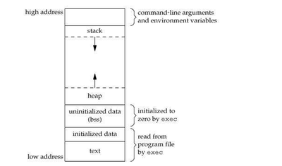

As far as I know, .text, .data, .bss, heap and stack makes up the RAM. I dont understand this concept well, because code (.text) is loaded into FLASH not RAM. Even flash and RAM size differs a lot, Flash is 8x more than RAM. Thats why RAM region can not be used for storing the .text. I believe I am missing something. Please see below what I have found on google.
Could you please guide me with this ?
