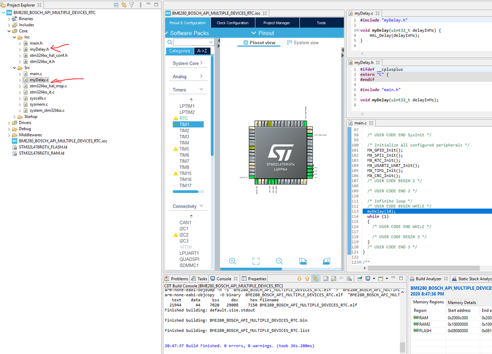

2020-11-11 12:03 PM
Thanks for sharing.
Based on your .ioc I've created a project relying on File > New > SM32 project from existing .ioc file.
I've added then myDelay.h / myDelay.c files plus related function call as part of main.c.
Then whatever I'm doing (adding / removing a middleware or IP) from Device Configuration Tool editor view code generation is hopefully preserving my addons.
Adding files this way is a way. Plenty others are possible and supported. High level depends how complex your project is, how you are expecting to organize it, ...
I would say so no issue but feel free to share more about your working model. I may have missed something.
