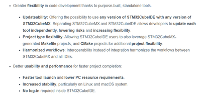

There are two main reasons: flexibility and performance:

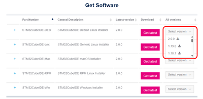

@jcslb wrote:I've felt compelled to revert to version 1.19.0 ( go to Help -> About STM32CubeIDE -> Installation Details -> Installation History -> select version -> Revert)
You can download previous versions from the website:
You can install & use multiple versions at once.
