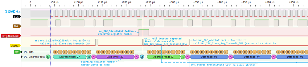

The diagram above summarizes the problem. The critical area is detecting Repeated Start before the slave must transmit to the master. Using the GPIO poll technique I described earlier, it is possible to operate at 100KHz SCL without clock stretching but I’m hoping there’s a formal way to do this.
