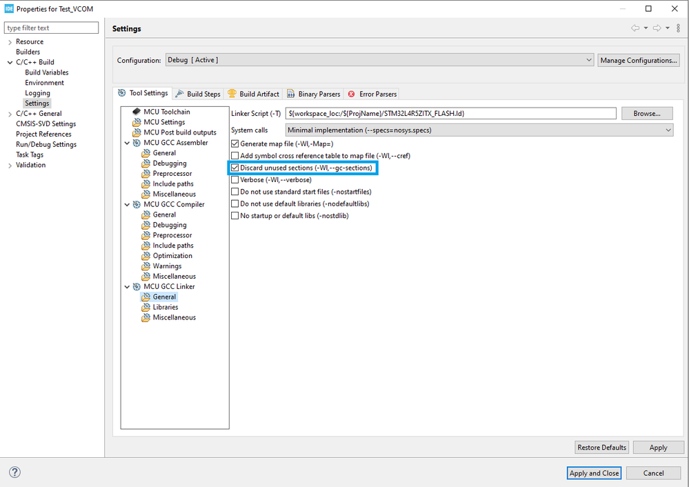

Hello @jose Navarrete Pineda
The option you are asking for is already activated by default in CubeIDE. Under "Properties / C/C++ Build / MCU GCC Linker / General" you will find a check box associated to the "-l--enable-non-contiguous-regions" option.

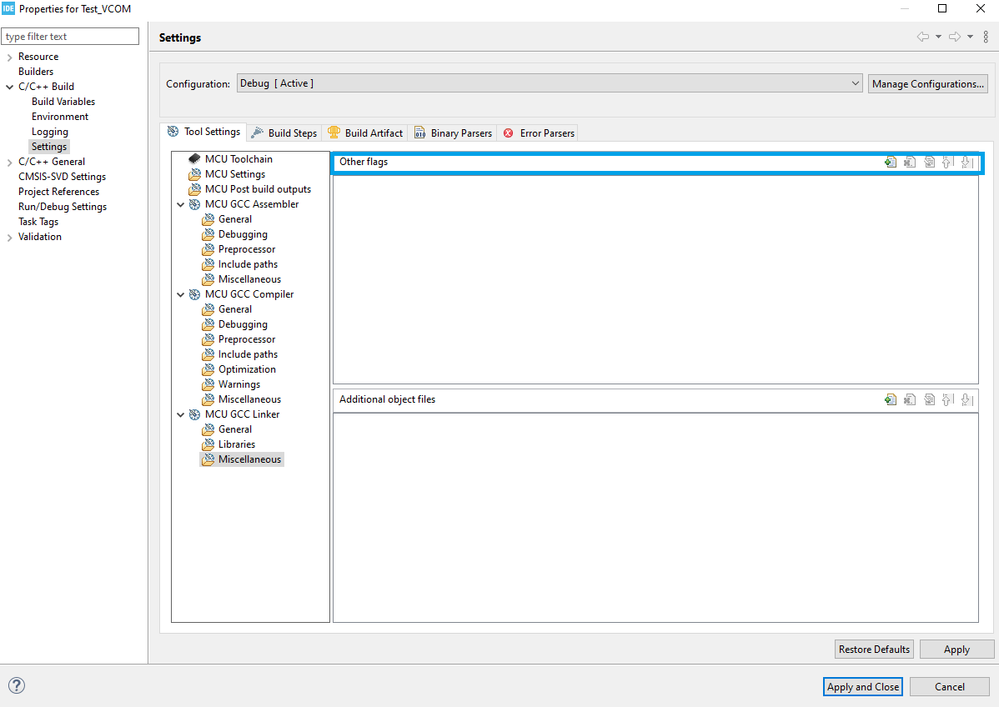

I just want to add that in case you need to add any GCC Linker command, which is not already embedded in the tool, go under "Properties / C/C++ Build / MCU GCC Linker / Miscellaneous" and add the command in the "Other flags" section.
