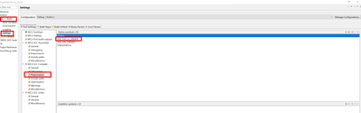

2024-01-27 11:59 AM
I have found the issue. The copy is correct actually, but the build settings are different. So, the solution is to add USE_FULL_LL_DRIVER into project --> properties --> settings --> C/C++ Build --> settings --> MCU GCC Compiler --> Preprocessor --> Define symbols (-D). Click Add, and type USE_FULL_LL_DRIVER.

2024-01-27 11:59 AM
