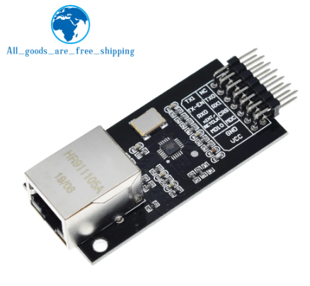

right. need interface chip. i would take a cheap module, like this:
https://de.aliexpress.com/item/1005004446133417.html
already with rj45 ...

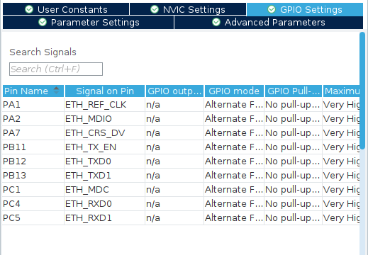

to connect : gnd, vdd , and these 9 pins:
2023-02-17 12:08 AM
which board ? selfmade STM32F407 ?
STM32F407 chip has RMII interface, not rj45.
