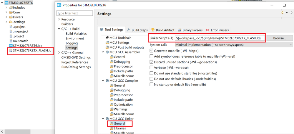

I am migrating STM32L073RZTx project from IAR to STMcude IDE. following error is showing while compiling in STMcude "Cannot find the specified linker script. Check the linker settings in the build configuration". Can any one help me solve the issue?

Florent V
Please check if the path to the linker file set in the build properties of your project matches with your need. As the following screenshot for example:
Regards,
Florent
