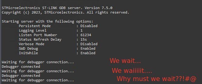

...crawling its way to completion 50 times a day, like I am?
If you need to start a debug session in CubeIDE, I'm afraid I don't have any good news for you.

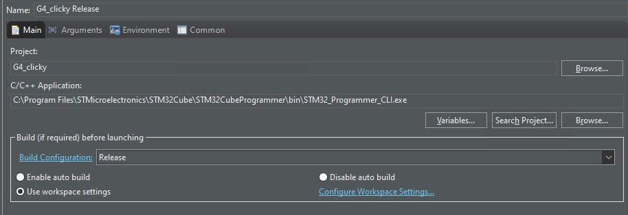

Now, you can create create a batch/shell script for your project which launches a specific binary. test that script in the command line to make sure it works.
Then, in CubeIDE go to run/Run Configurations, and create a new "C/C++ Application" (NOT a "STM32 C/C++ Application", as that launches the GDB based downloader), and choose your shell script as the program.
Choose your desired project/build type. Whenever you make changes, the associated build will be triggered and will generate a new elf binary for download.
That's it, now you can lunch your shell script as a run target. It will compile the project if necessary, and download it to your chip in the blink of an eye. No more "Waiting... Waiting...... Waiting.......................".

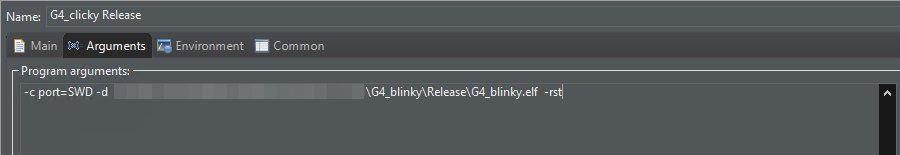

P.S.
You can instead use the programmer cli binary file as the executable program for the run target, and setup the command line arguments as part of the run target config.
