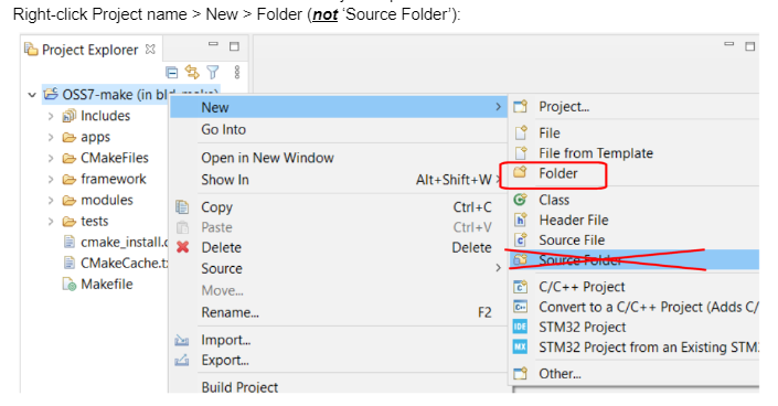

But, if you really do want to do it, you can add a file as a "link":

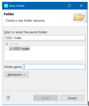

This takes you to:
Choose 'Advanced>>'

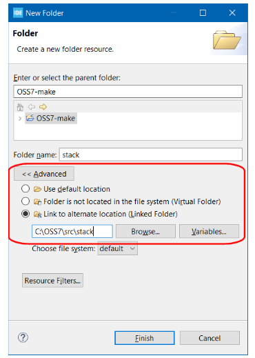

Then choose ‘Link to alternate location’, and enter the path to your source files:
