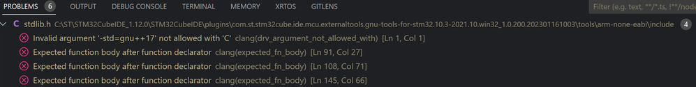

-IC:\ST\STM32CubeIDE_1.12.0\STM32CubeIDE\plugins\com.st.stm32cube.ide.mcu.externaltools.gnu-tools-for-stm32.10.3-2021.10.win32_1.0.200.202301161003\tools\arm-none-eabi\includeHowever, this produce errors like this:
You get the point, some flags should be provided for the C compiler, some for the C++ compiler. How to achieve that goal?

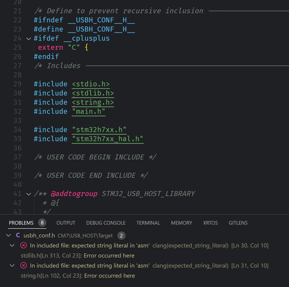

- "-I/source/embedded/stm32-gnu-tools/arm-none-eabi/include/c++/10.3.1/arm-none-eabi/thumb/v7e-m+dp/hard"File .vscode/compile_flags.txt contains only my project include paths.
Most of the files are processed without errors, however, I still get something like this:
