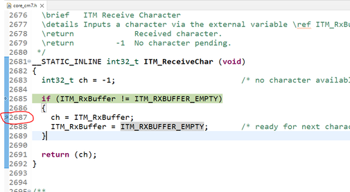

extern volatile int32_t ITM_RxBuffer;
volatile int32_t        ITM_RxBuffer = ITM_RXBUFFER_EMPTY;
int SER_GetChar (void)
    return ITM_ReceiveChar();
Breakpoint at Line 2687 is never reached.

@ferro wrote:
This means that you didn't receive any character as the buffer is empty according to the if condition.

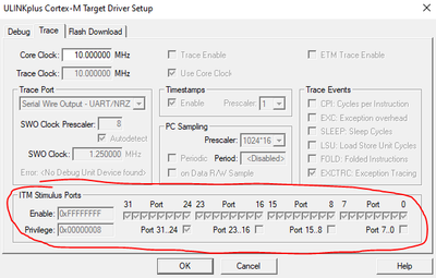

I remembered ITM settings in uVision - is something similar in Cube ? Is ITM in Cube set for semihosting internally ?

As I said, I have no clue what I am doing. Just trying to copy what is working (ITM) on my other project (Cortex M3, Ulink, uVision, clang) where someone else got it working. It does not need to be ITM.
See this video, especially at @1:12 for ITM configuration.
