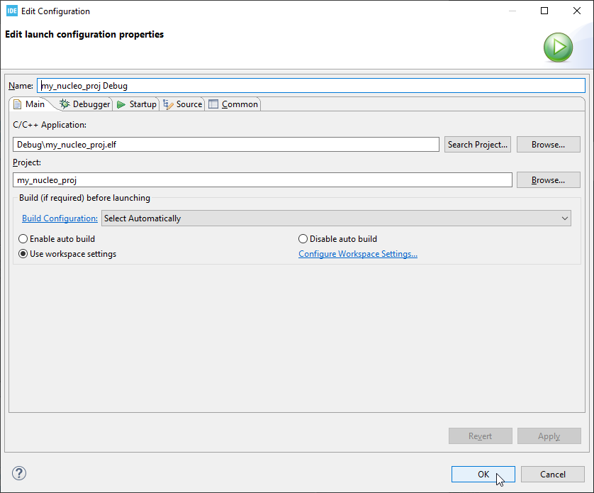

$ /c/ST/STM32CubeIDE_1.6.1/STM32CubeIDE/stm32cubeide.exe -clean -clearPersistedState -data /c/tmp/temp_workspaceClick "Start new STM32 project". From the Target Selection wizard, I go to Board Selector, choose NUCLEO-G071RB, -select the board, Next. Project name: my_nucleo_proj, keep the rest at defaults, click Finish; say Yes to other defaults in dialogs during project creation.

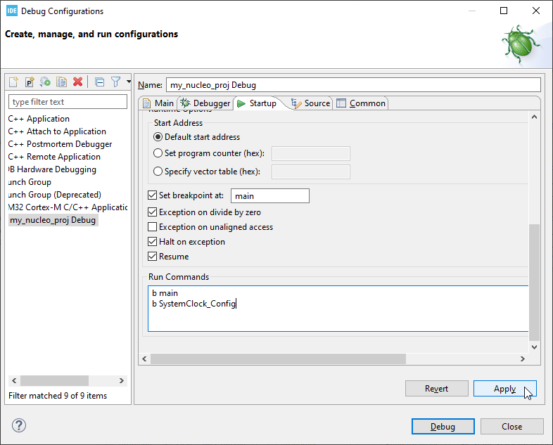

1 file changed, 2 insertions(+), 2 deletions(-)Back to STM32CubeIDE: click Run / Debug Configurations / Startup (tab); check again "Set breakpoint at: main" ; then under "Run Commands", type or copy/paste the following:
b main
b SystemClock_Config
... then click Apply, then click Debug. The debugger starts, and as expected, breaks at main; click Resume, then as expected, debugger breaks at SystemClock_Config; click Resume, and as expected, debugger does not break anymore. In Debugger Console, we have:

Final step: Back to STM32CubeIDE: click Run / Debug Configurations / Startup (tab); then under "Run Commands", erase all previous commands; click Apply, then click Debug.
The debugger starts, and as expected, breaks at main (because of the checkbox); click Resume, then UNEXPECTEDLY, debugger BREAKS at SystemClock_Config again:

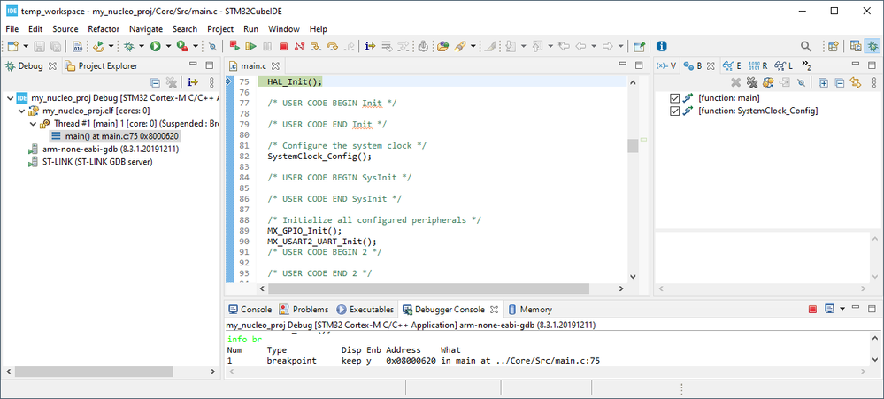

2021-04-28 4:22 PM
Thanks a ton, @alister,
> Could you merely clear it in the Breakpoint window?
Yup, that was it - I was unaware of the Breakpoint window (just started with STM32CubeIDE) - and so I did Run/Debug again, when the debugger halted, I did Window > Show View > Breakpoints (the Breakpoints entry seemingly shows up only while debugging); and indeed - I could see those two breakpoints there:
Since it turns out, you can type in Debugger Console as well, info br confirms it is the same two breakpoints!
So, all I had to do was to Ctrl-A in the Breakpoints window to select them all, right-click, then choose Remove All - they were gone!
Terminated that debug, did Run / Debug again - and finally, they do NOT hit anymore (only the Temporary Breakpoint 1, that corresponds to the checkbox for breakpoint at main in Debug Configuration, hits - as expected); so, problem solved!
