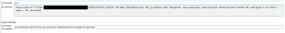

I added an -fexceptions flag to the linker script using the Properties menu, but can't find how to remove --specs=nano.specs from the script
Properties->C/C++ Build->MCU G++ Linker
The "All options" is grayed out so I can't edit it.

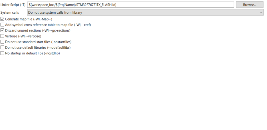

Properties->C/C++ Build->MCU G++ Linker->General

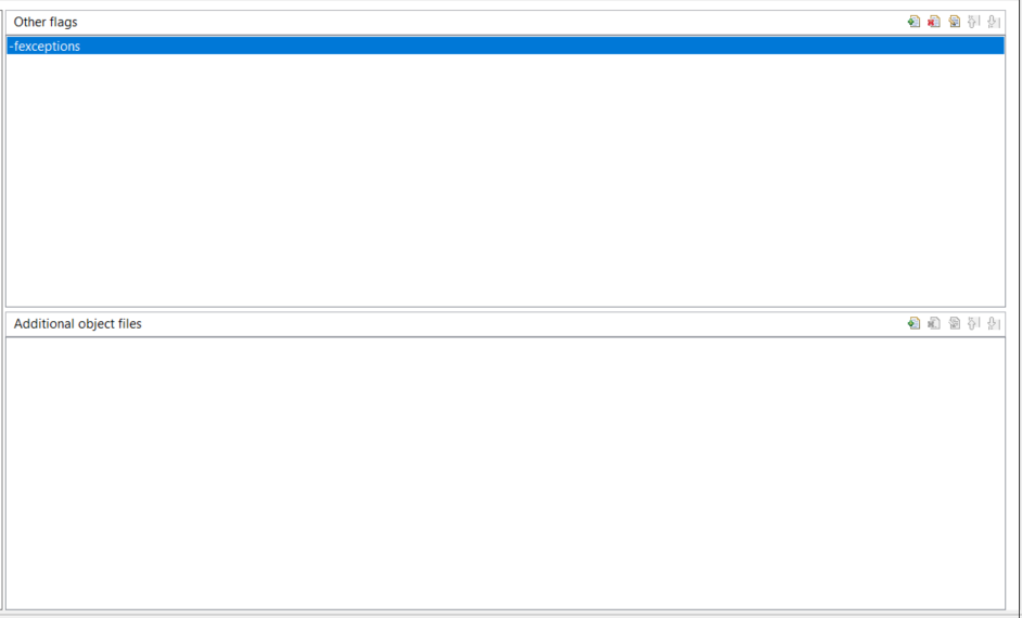

Properties->C/C++ Build->MCU G++ Linker->Miscellaneous

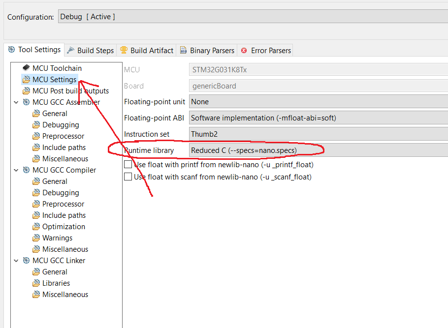

I think this is what you are looking for?
2021-12-18 8:17 AM
Ah, yes, that's it. I thought it'd be under linker settings, my mistake
