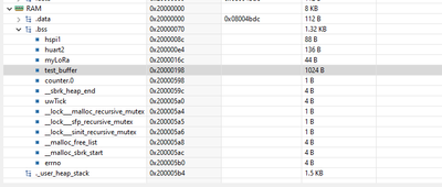

I have created a 1KB buffer:
volatile uint8_t test_buffer[1024];
and then I perform some actions in while loop:
while (1)
HAL_Delay(1500);
/* USER CODE END WHILE */
static uint8_t counter = 0;
test_buffer[counter] = 5;
counter++;
/* USER CODE BEGIN 3 */
I can confirm that I can see the variables in memory details:
test_buffer is  a global variable. It's in the .bss section (which are implicitly zeroed global variables) so you won't see it in the stack analysis, as it's not created on the stack.
