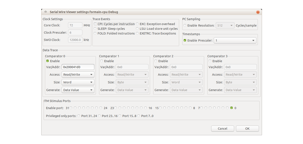

Hi Markus,
There's no particular setting to the SWV:

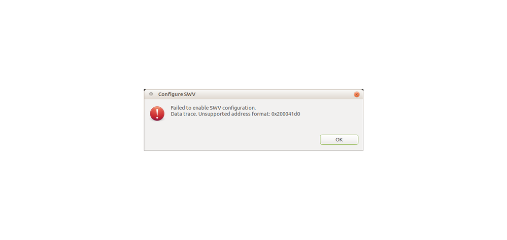

The screenshot above shows my attempt to use an address instead of the variable name. Now that's even worse than with my previous attempt last week, I get this error message (not when clicking the SWV settings dialog box OK button but when activating the trace record option).
For this particular test case, the address is the one corresponding to the variable name used when it works. With the real use case, the address is pointing to a struct field.

Ah, I did some digging in our ticket system.
It looks like this was a regression bug introduced in STM32CubeIDE 1.9.0.
I did a test on my newly installed version, STM32CubeIDE 1.10.0 (released last week) and it works.
So if you want to trace using the address you would either need to download the previous version of 1.8.0 or move to the newer version 1.10.0.
Let me know if you run into any issues in any of those versions!
2022-07-04 6:08 AM
I just updated to v 1.10.0 and I can confirm that using the address it's now working properly. Thank you for the advise.
