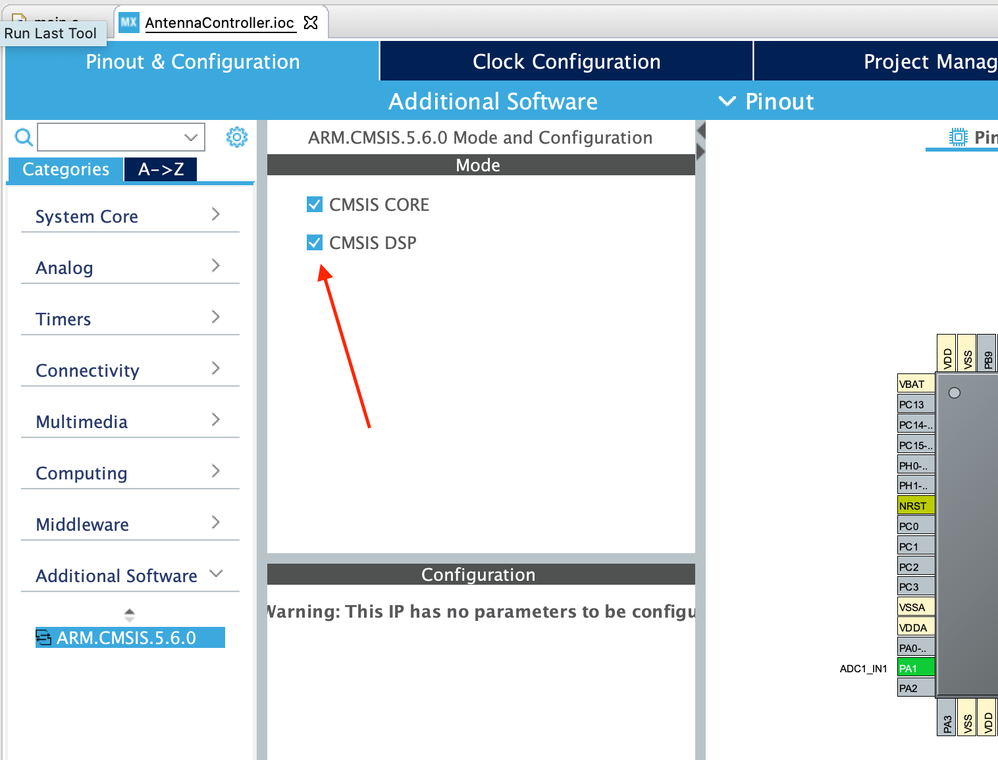

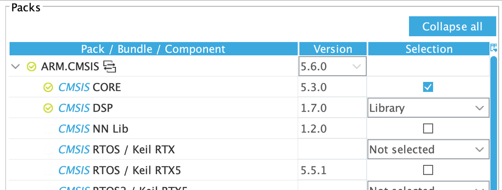

Then, in my project, in the .ioc file, I selected "Additional Software" and added the CMSIS packs:
I selected to add the DSP pack as "Library".
This stem was not enough so I had to activate both packs in the .ioc file:

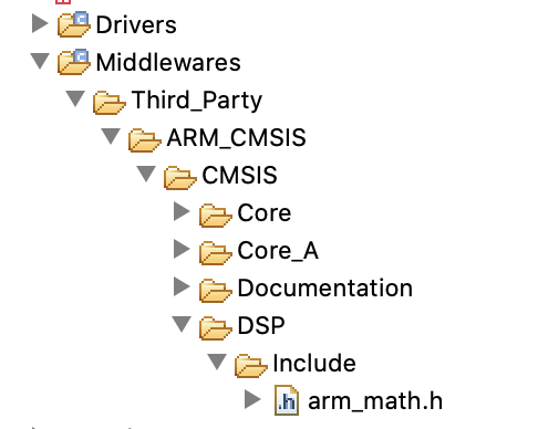

So after all these steps, I had my Middleware include files added to my project:

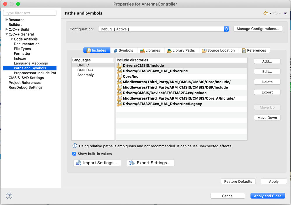

Even the include directories were automatically added to the project settings as can be seen in the following picture:
However, the libraries (.lib) are not added to the project.
I've tried adding the ARM_MATH_CM4 symbol to the project settings but it didn't help. I've also tried to add the pack as "Source" but it didn't compile.
