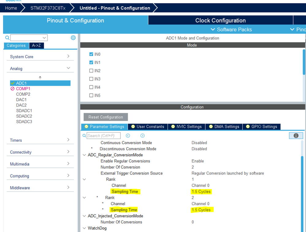

In projects I've done with other STM32 MCUs, STM32CubeIDE allowed me to control the sampling time for individual ADC channels. However, with a new project (using a STM32F373C8Tx), I don't see where this option can be set.

In the ADC configuration, same as other chips. Ensure you have the number of channels you want set.

Ah. I missed the little arrow to the left of the "Rank" option. It needed to be expanded before I saw the Channel number and Sampling Time options.
Thanks!
