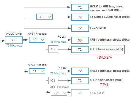

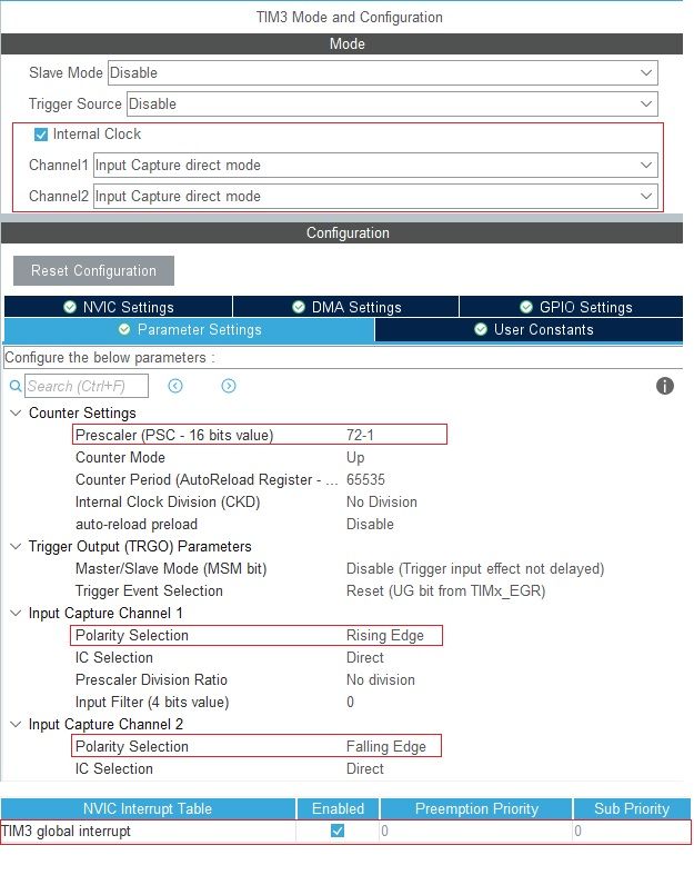

The TIM3 on STM32F103 is 16-bit timer.
To improve accuracy, the prescaler of timer3 was set to 1 MHz.
Please refer to the sample code below, and you can modify it as you wish.
/* USER CODE BEGIN 0 */
uint32_t cap_val1 = 0;
uint32_t cap_val2 = 0;
float frequency = 0;
float duty_cycle = 0;
void HAL_TIM_IC_CaptureCallback(TIM_HandleTypeDef *htim)
    if (htim->Channel == HAL_TIM_ACTIVE_CHANNEL_1)  // Input Capture Channel 1 (Rising Edge)
        cap_val1 = HAL_TIM_ReadCapturedValue(htim, TIM_CHANNEL_1);
        TIM3->CNT = 0; // Clear TIM3 Counter
    if (htim->Channel == HAL_TIM_ACTIVE_CHANNEL_2)  // Input Capture Channel 2 (Falling Edge)
        cap_val2 = HAL_TIM_ReadCapturedValue(htim, TIM_CHANNEL_2);
        frequency = 1000000 / (float)cap_val1;
        duty_cycle = (float)(cap_val2 * 100) / (float)cap_val1;
/* USER CODE END 0 */
int main(void)
    MX_TIM3_Init();
    /* USER CODE BEGIN 2 */
    HAL_TIM_IC_Start_IT(&htim3, TIM_CHANNEL_1);
    HAL_TIM_IC_Start_IT(&htim3, TIM_CHANNEL_2);
    /* USER CODE END 2 */
saurabhkore
Associate III
Hii youre code is correct,but need to change in cube ide settings.
TIM3->Clock source->Internal clock
->combined channels->PWM input on channel 1
After this settings just generate code and using capture callback function measure frequency.
